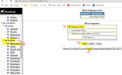

4: Let's fix the issue, please follow the following steps to fix the issue, forcing the Switch to boot from the primary partition containing the SPS (switching code).
Configure left>System>Boot sequence>Select primary flash >ADD>Save>yes
When it comes back this time, the Switch should boot from its primary partitions.
Note: if you got an error message that Boot sequence already exists., hit delete first and follow up the steps back.

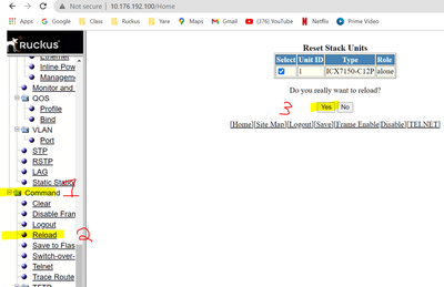

-Now let’s complete the process by reloading the Switch:
Command>Reload>yes
