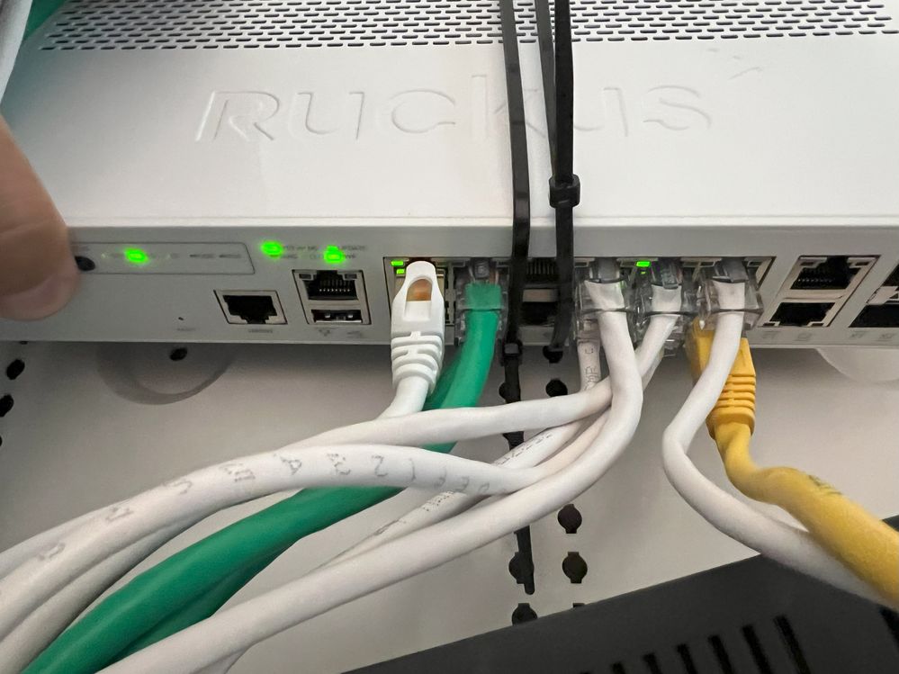

07-10-2023 01:20 PM
Hi @MiSNemesis
The output of the commands seems normal.
Could you please let me know if your Access Points have any of the lights ON?
07-10-2023 01:25 PM
No lights at all. when I look at the Switch, there is no connection going on with the network cables. I rebooted the switched and remove and plug the cables back in. Still no lights.
07-10-2023 01:28 PM
Hi @MiSNemesis
Could you please plug the APs ethernet cable on other ports (any within 12 ports as shown in the below screenshot) and try check the AP again?
07-10-2023 01:33 PM - edited 07-10-2023 01:35 PM
I removed and move to another empty port. Still no lights.
