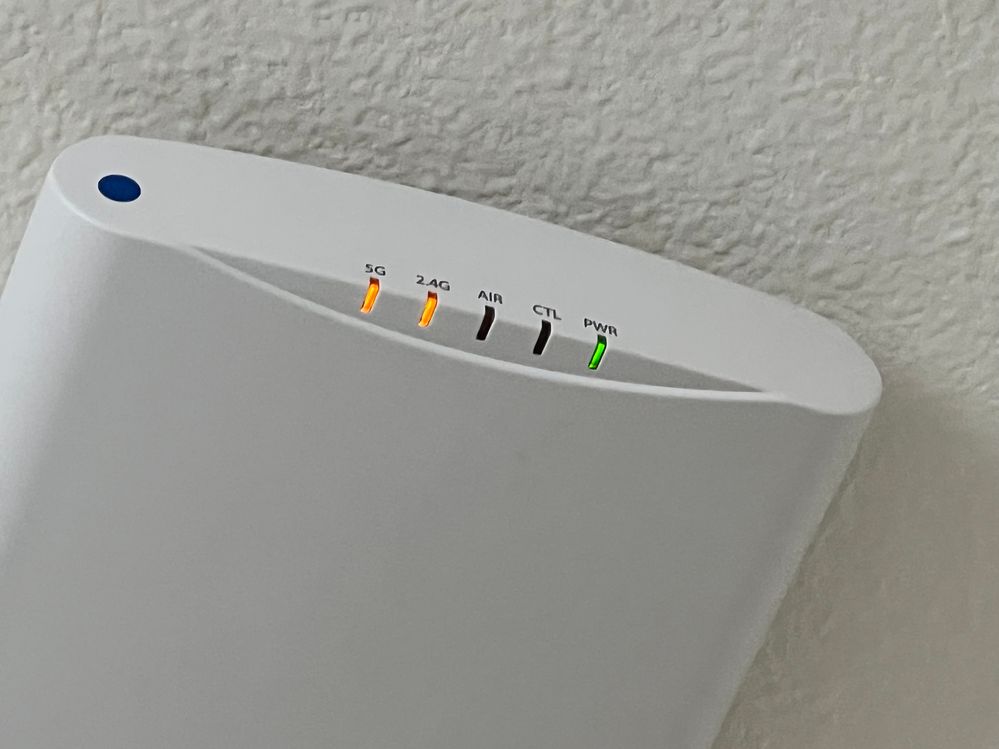

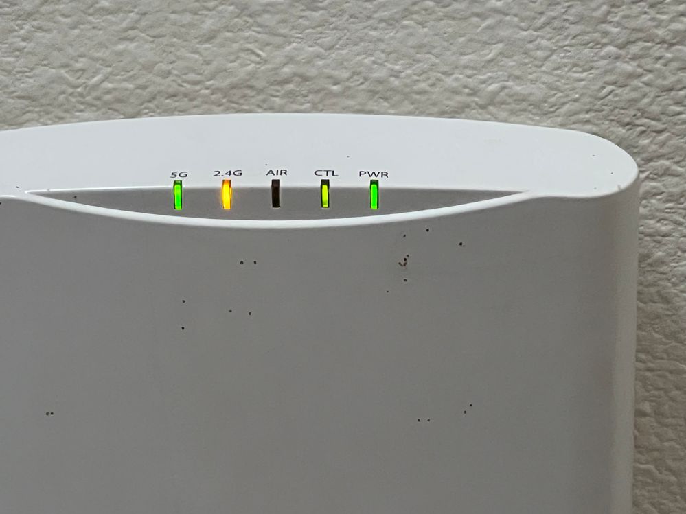

Seems like it’s stable. In the morning when I looked at RUCKUS upstairs it showed all red lights but now it doesn’t.
Thank you for all you timely response and guidance to resolve the issue.

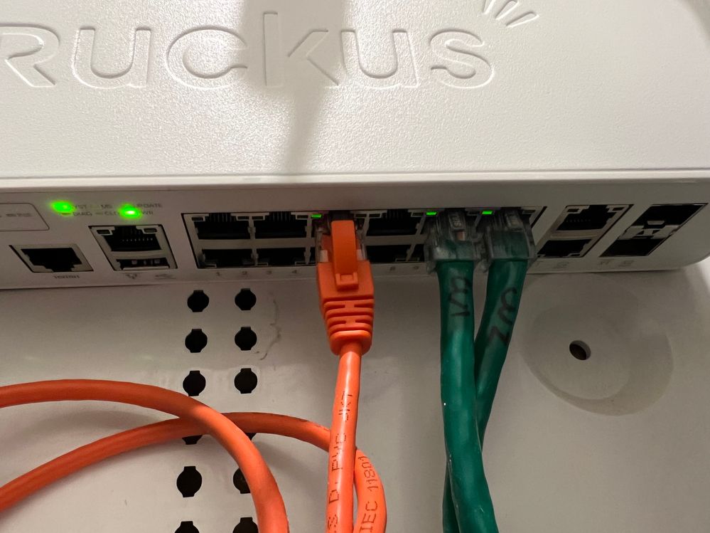

Hi @Jyothik16
As per the pictures you shared, light status of the Switch and the Access Point seems to be normal.
