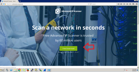

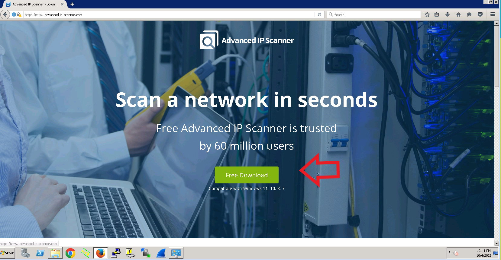

https://www.advanced-ip-scanner.com/
NOTE: IMPORTANT VIDEO TO WATCHhttps://youtu.be/O1lerd0IFg0

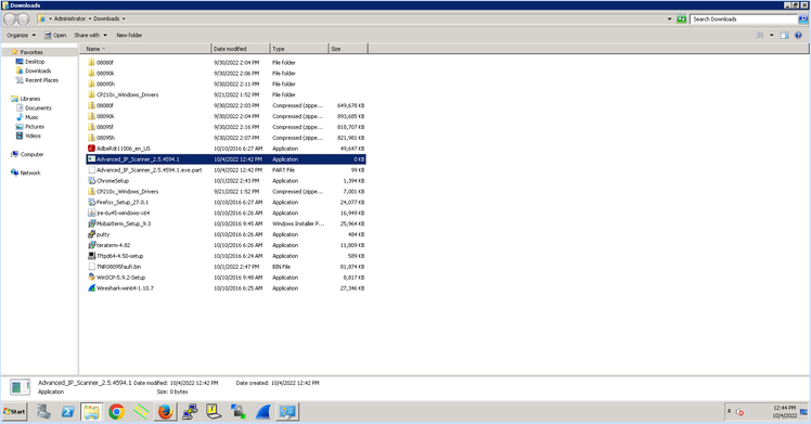

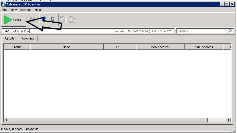

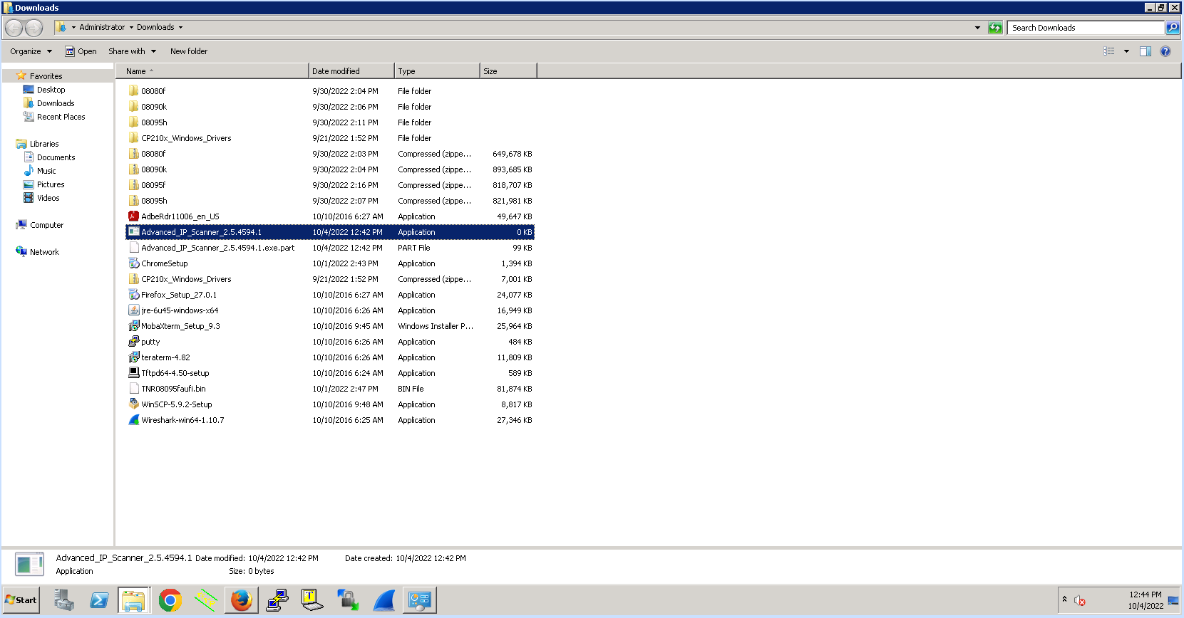

1 ) Downloads the application

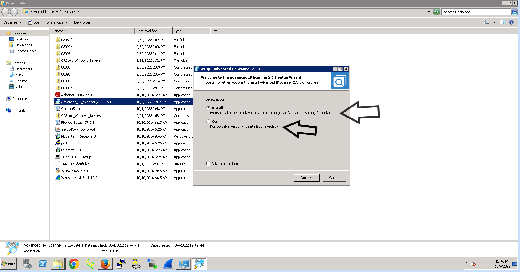

2 ) Proceed to install (it can be portable ‘does not need to be install’ or install.exe that install the app in your computer)

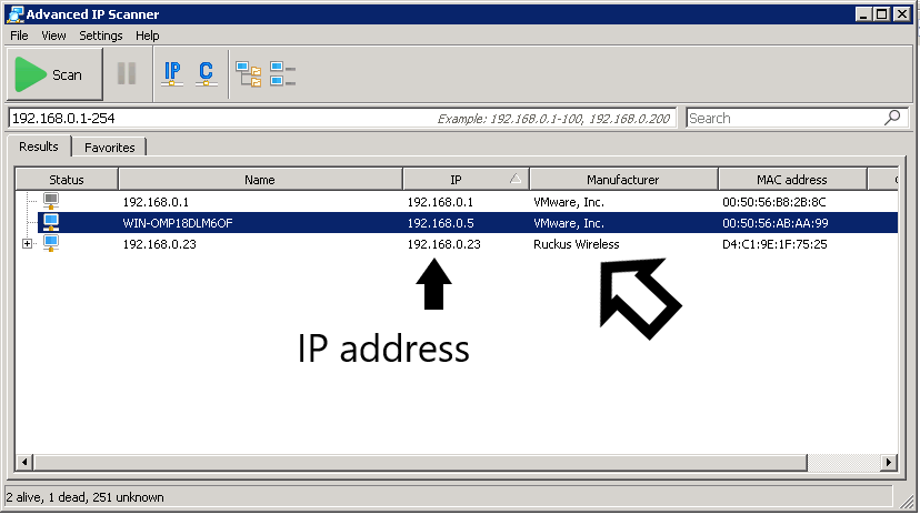

3 ) Once is installed (open the app) and then click the Start bottom to star running the scanner
4 ) Ruckus devices are going to be detected as Ruckus Wireless / Ruckus Switch / Ruckus Router / unleashed as the shown example:Vsquez_Fer_5-1666283876791.png
Video link as reference: https://www.youtube.com/watch?v=0zxgUn_Tm08

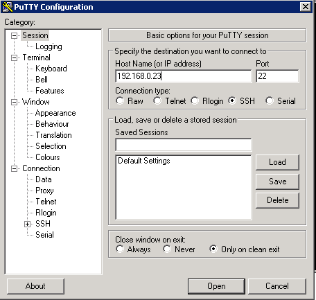

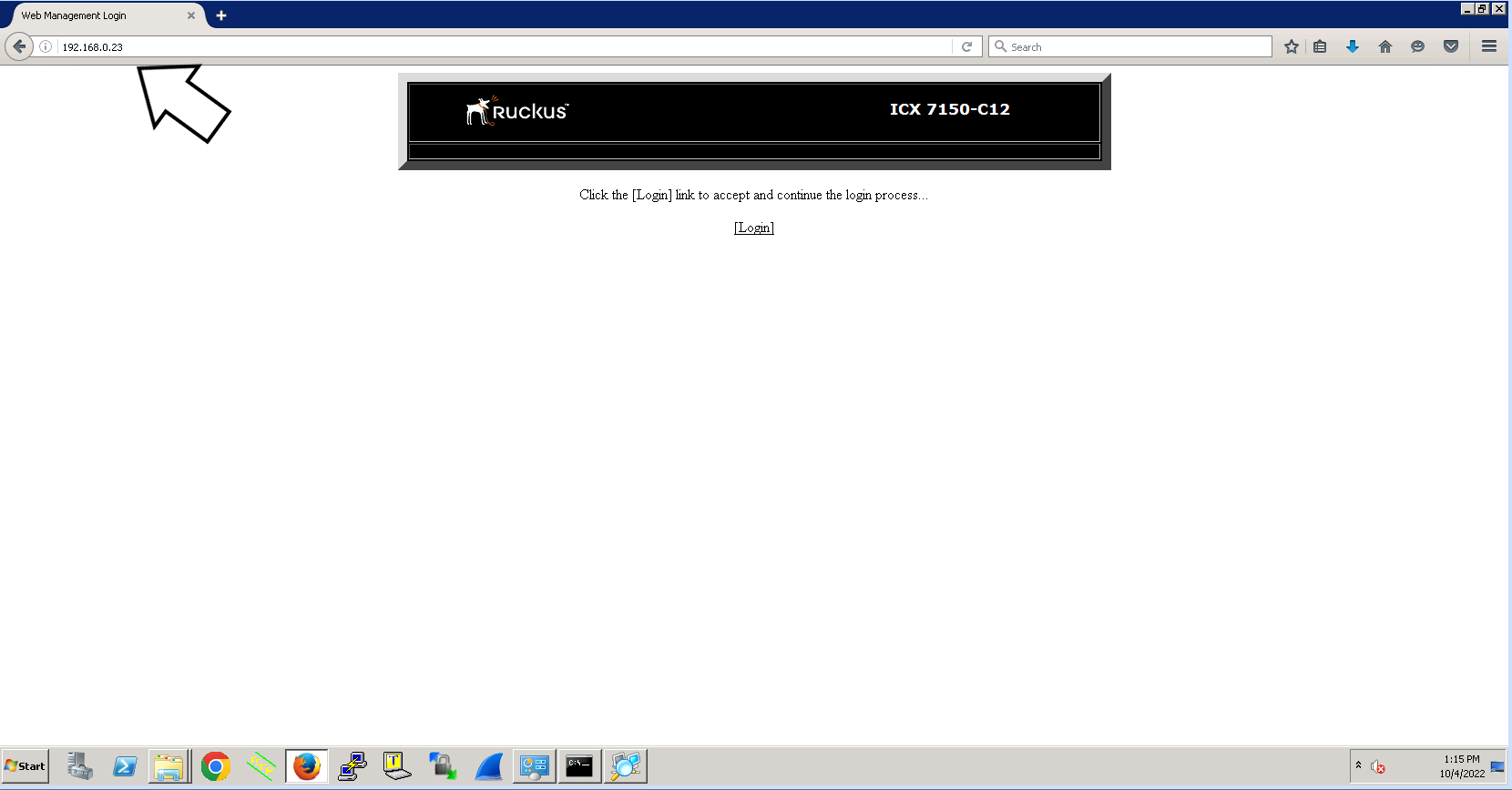

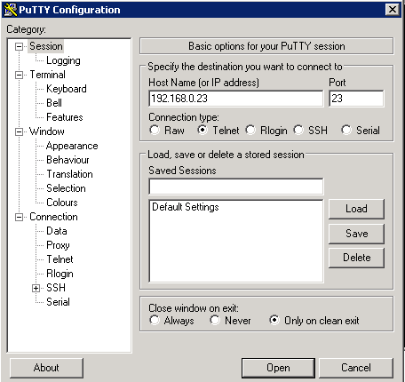

5 ) Since we already know the IP for the Ruckus switch (192.168.0.23) , I can access to the switch via Web/ssh/telnet
Webb access example :
SSH example:
Telnet example :
