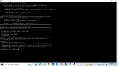

while accessing command line through putty and selected telnet and executed commands shared and attached is the screen shot

Apologies, as I cannot see the required information from the screenshot you shared, please share another screenshot showing the output of the commands. (Please refer to the below screenshot)

This issue is because your switch is running on the Routing code (SPR). The Switch should run on the Switching code (SPS) to avoid these issues for Lennar home users. Due to a power outage/power spike, the Switch boots up on the other partition which may be running on a ‘Routing Code’ results in causing this issue.
As I can see from the output you shared, your Switch is booted up on the secondary partition which is running on Routing code (SPR) as highlighted in the below screenshot.
