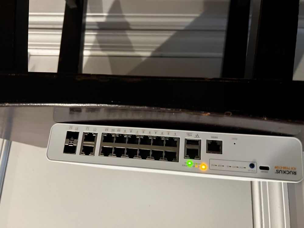

08-29-2023 07:51 AM
1. These are the lights that are on.
2. Yes, the internet connection from the Internet Service Provider (ISP) is stable and working.
3. 2 R510 Access Points are connected to the RUCKUS ICX-7150-C12P Switch.
08-29-2023 08:32 AM
Hi @KColeman
As I can see from the picture you shared, there are lights on PWR and SYST, if there is an amber/orange light on the "SYST" and a green light on the "PWR" on the Switch (as it is in the below picture). Meaning the Switch is stuck in the boot mode.
Basically, due to the power outage/ power spike, the switch went to a state that we call ‘boot mode’ that is not able to boot up properly.
First, we will try to reset the Switch as described below:
IF RESET IS NOT WORKING, PLEASE TRY TO RESET YOUR SWITCH MULTIPLE TIMES (Like 10-15 times) AS DESCRIBED ABOVE.

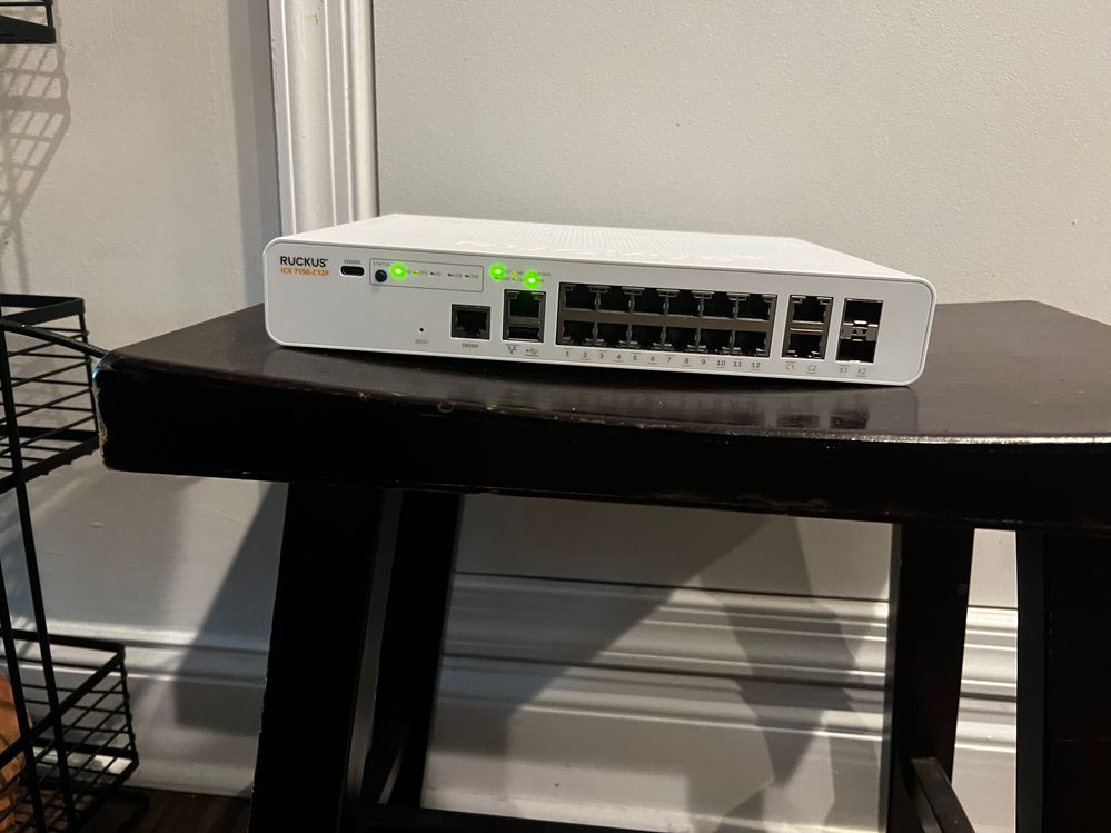

08-29-2023 10:32 AM
I've done the reset. The lights are green. How do I connect it now?
