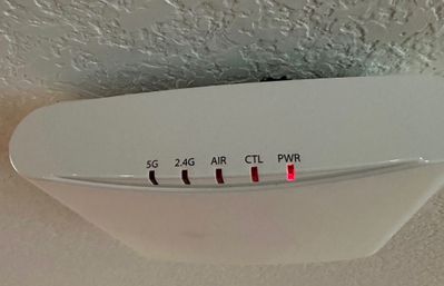

The Access point is stuck in boot mode, so please perform a factory reset, let me add the steps, if the Access point still not responding, please reply with a picture showing that the PWR is red.

12-29-2022 12:39 PM
Hi Yarenis,
I performed the factory reset multiple times with no success.
Here is the picture of the AP with red PWR:
12-29-2022 12:46 PM
Hi @ On-the-green
Thank you for the details provided, based on the troubleshooting you have done since the access point is stuck in boot mode, this unit must be RMA (return merchandise authorization ), which means to replace it, please contact us via chat, comment that you already have a post that we have approved the RMA for you, copy the link from this post and paste it into the chat to initiate the unit replacement.
