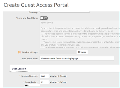

08-12-2022 10:15 AM
Hello @das2014 ,
You can find the configuration under the Guest Profile. Screenshot attached for reference:
Let me know if this helps!
Sarita
