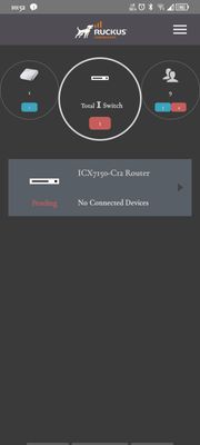

3. I will need some time to send the screenshot. However the "pending" status appears in my Unleashed application in my Android phone where I can see all devises connected to the network.

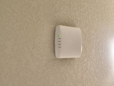

4. The master AP has 4 solid green lights. The "slave" AP is currently off. But when I power it up (connect it to the switchboard), it has two green lights. One is solid and another one is blinking. This AP distributes "Configure.me-......" network.

1-st AP (Master) lights appear like this:
2-nd AP (Slave) light appear this way:
Screenshot of the ICX in "pending" status in my Android app:

From the screenshots you provided, Seems like you are presetting the routing code issue
We have 2 ways to access to the Switch 1- In a logical way via Ip address (Ip address are logical addresses given by the local router) so we would have to track which IP is that of the Switch (that is using) or 2- via console access with a Type C cable
