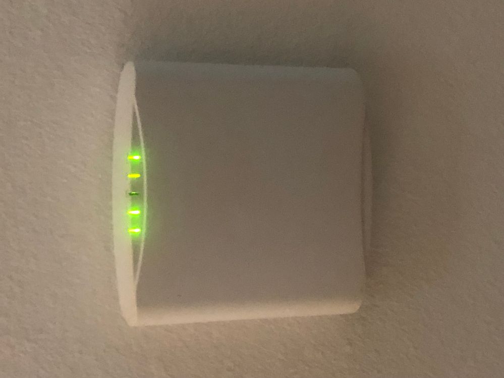

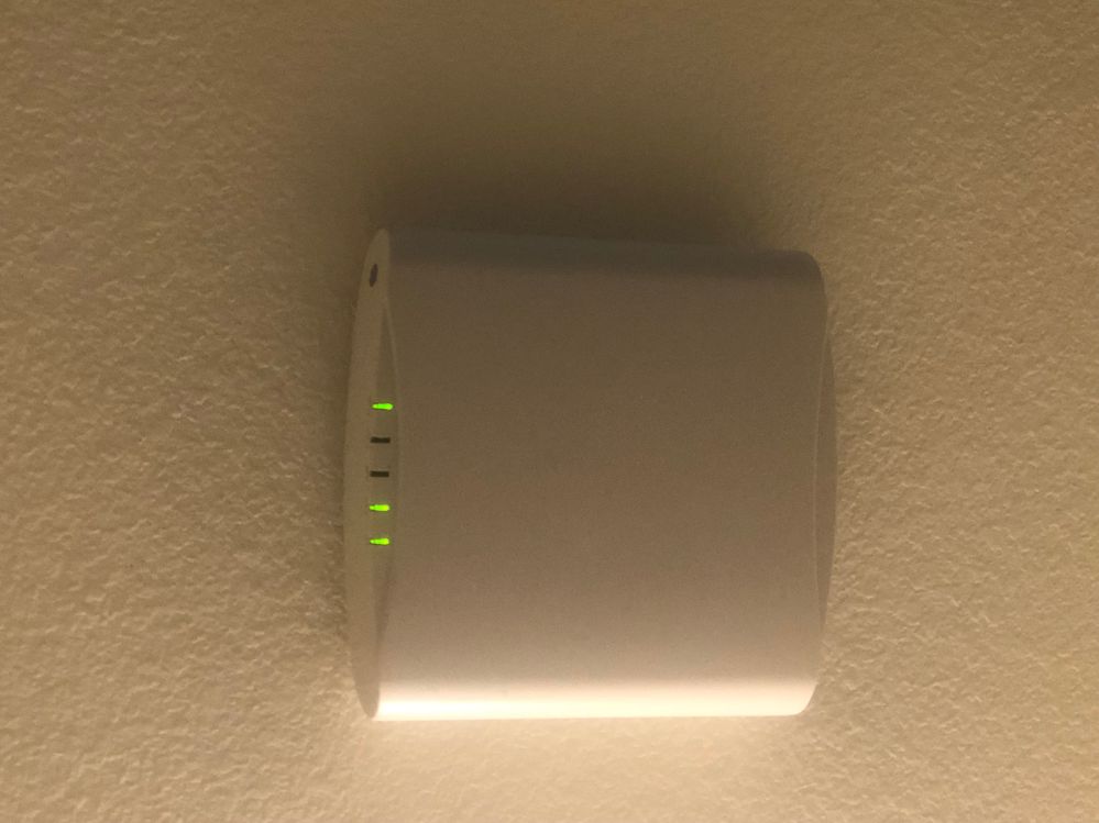

I did seek outside help, Geek Squad came out to me residence and they were stuck as well. They tested the main box and its seems to be working. Here are some pictures of the other boxes on the ceiling. Picture #2 all the lights are not on. How can we fix that one?All Lights onAll Lights onSome Lights missingSome Lights missinged the ICDX

Hi @krivas33
Based on your description, lights on 2.4 GHz is off which means that the WLAN service is down.
Please follow the below steps to make sure your access point is working fine or not?
1. Please check if this is happening on the ISP router or specific Access Point ?
2- Please check whether the cable is working fine or not
3- Please connect a PC directly to the Ruckus Switch ICX-7150 to see if you are having the same connectivity issue.
4- Also please try the physical reset of the AP using the following guide.
