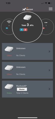

I have done the physical factory reset and the Living Room and Loft WAP's are still doing the exact same thing. And now, my Master is as follows:
5G: Green; 2.4G: Amber; AIR: off; CTL: Green; PWR: Green
And now this is how my Ruckus app looks:

I logged out of the app and logged back in and it told me I wasnt connected. So i reconnected to my WiFi and this is now what the app shows:

Hi @SD
Did you factory reset the AP by unplugging the cables of the other APs from the Switch panel except for the one on which you performed the factory reset?
If 2.4G and 5G lights are amber, it states that the connectivity is up and there are no devices/clients connected. When any device/client connects to the 2.4 or 5G radio the lights turn green. Please refer to the below link for more information about the light status of the RUCKUS R510 Access Point.
Please try to connect any device to the new SSID you created and check the internet connectivity.

04-24-2023 01:43 PM
Hello,
Yes. I made sure that only the Master was connected. I am going to try it a second time.
