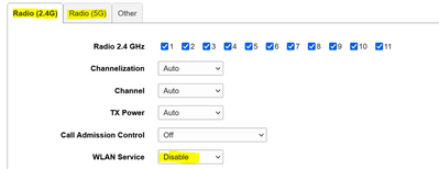

Doing great ! , Based on the color lights can be that the WLAN service was disable.

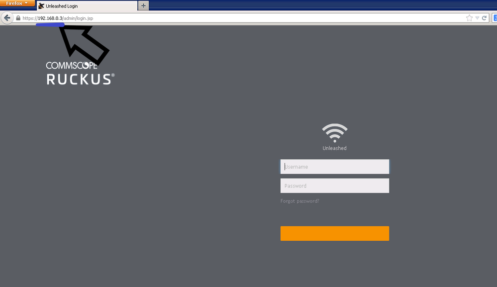

Please try to copy the IP address and past it in the URL to see if you are able to log in into the Unleashed web page like the following :
This credentials should be the same as the unleashed mobile APP

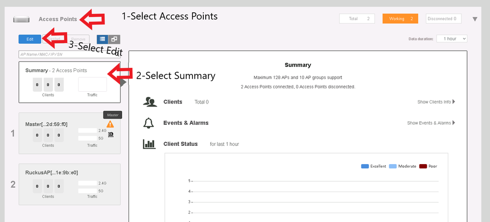

Select Access Point>>>>>Select Summary >>>> Edit

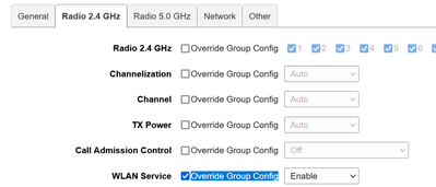

Verify Status of WLAN service>>>> If Disable>>>Change to Enable on both the radio and Click OK.
Make sure it says enable on 5G and 2.4G

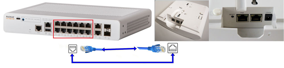

2-Physical option : Please read the following guide carefully: make sure you only have  (1) the access point plug on the ICX-7150-C12P, the one still connected to the switch is the one that the factory reset will work on
