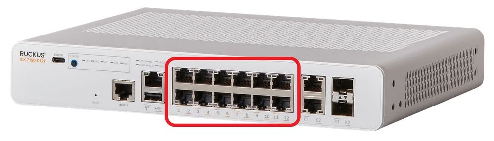

Hi @tanchen75
Please make sure the cables are connected correctly the cable from the Router ( ISP ) internet provider is connected to 1 of the 12 ports (in the red section) .
