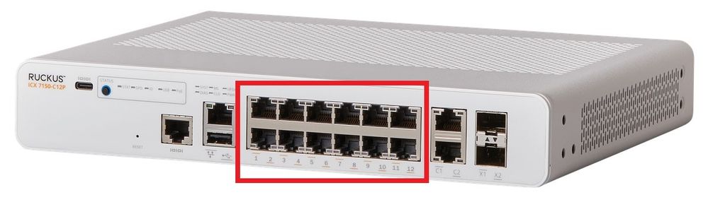

Hi @Ashu1701
Please check whether the cable from the Router ( Local ) ISP to the Switch is plugged in properly in any of the 12 ports available, as shown in following example:
