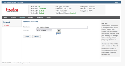

see the below pic please. this is from my internet provider and it can see the switch i think. What do I do from here if it's relevant?

08-21-2023 12:53 PM
I was not able to figure this out nor was an IT person. I have solved it by bypassing the switch by connecting a POE Injector adapter and works just as fine as the IP address switch has. This has been an inconveniece for Lennar to pass on customers to a community page where this has taken time off of my work and time. The switch to me is now a piece of worthless junk. Thank you for trying but i wished someone w/that expertise would come out here or at least go on our computer or the very least call us and walk us through this.
