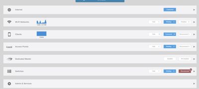

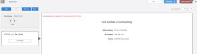

Hi @dwdchen
Could you please login to your Unleashed system on a WEB BROWSER using the Master AP IP Address or https://unleashed.ruckuswireless.com/ and share a screenshot showing the Switch in disconnected state?
Thank you again.
dwdchen
New Contributor III
Hi Imran,
Please see below
Hi @dwdchen
We may need to check the Switch version and some configuration. Please follow the below process and help me with the queries.
ICX7150-C12 Router> OR
ICX7150-C12 Switch>
show version
show flash
show inline power
show interface brief
