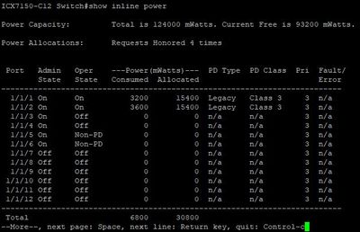

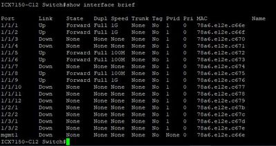

Please see the screenshots of the commands you had me enter.

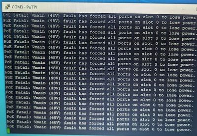

Also there is a additional screenshot that I provided when the AP units were offline (I power cycled after and was able to enter in the commands after this). It said "PoE Fatal: Vmain (48V) fault has forced all ports on slot 0 to lose power." and it kept repeating nonstop. Again this went away after I power cycled the switch.

Hi @dwdchen
As I can see from the screenshots you shared, your RUCKUS ICX-7150-C12P Switch is on an older 08061a version causing this issue. (Please refer to the below screenshot)
We suggest you follow the below guide link to upgrade your Switch to a stable UFI version:
As you can access CLI, We suggest to follow the 2nd option from the guide.
dwdchen
New Contributor III
Hi Imran,
So I did go through and finished the update. So far it looks good. This process has been quite difficult. I really wish we could have spoke over the phone instead or something. I did run into a hiccup with the first update with the file ending in f. The file updated properly but the last step when I needed to boot it, it didn't entirely complete booting. It stopped internet access and kept giving me that PoE Fatal error again after it got to a certain point. I kept power cycling the switch and it just kept trying to boot up again then gives me the same error. My fix was by power cycling then quickly entering in the next command to copy the next update file. Doing this saved me and it finally worked out and loaded up properly. I was able to finish the updates. Hopefully I won't have anymore issues. I will let you know if I do. Is the update ending in g the most up to date one or should I update further? I just dont want anymore issues....or resolve them now when I still have some knowledge of how to do it.
