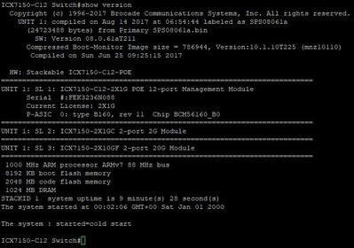

Hi @dwdchen
As I can see from the screenshots you shared, your RUCKUS ICX-7150-C12P Switch is on an older 08061a version causing this issue. (Please refer to the below screenshot)

Hi Imran,
Please see the screenshots of the commands you had me enter.
Also there is a additional screenshot that I provided when the AP units were offline (I power cycled after and was able to enter in the commands after this). It said "PoE Fatal: Vmain (48V) fault has forced all ports on slot 0 to lose power." and it kept repeating nonstop. Again this went away after I power cycled the switch.

12-20-2023 11:07 AM
Hi @dwdchen
