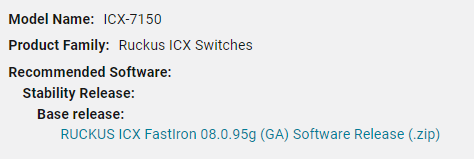

I highly recommend you to move the switch to the recommended version base on the support site ( 8095g ) to avoid this problem or issue in the future.
