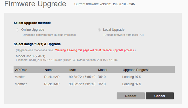

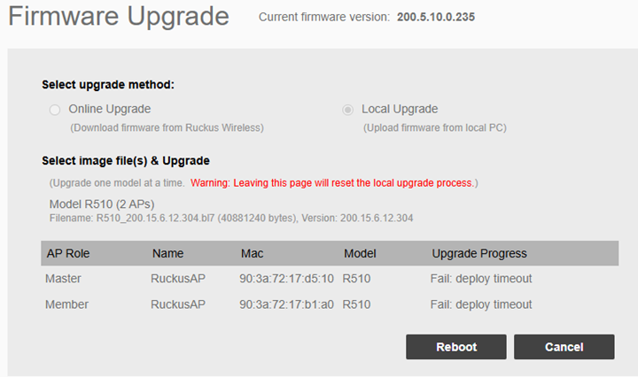

I have tried for years (since 2019) to apply firmware updates to the 2 R510 APs on my Lennar installed network. Thought it might be related to the Switch (ICX7150) firmware being outdated, so I updated that to the current recommended release. Still not able to upgrade the R510s. Same behavior and error as in the past. Using Unleashed, I supply the local firmware upgrade file (R510_200.15.6.12.304.bl7). The app confirms the file and I hit the Upgrade button. It slowly uploads to both the Master and Member APs at the same time/rate. Right after hitting 99% the app reports "Fail: deploy timeout" I have rebooted the APs and rebuilt the Unleased network multiple times. I have power cycled the APs. Any help is appreciated!

I have already invested about 20 hours in reading posts and replies on this forum and attempting various solutions. So far, none have worked. I have attempted to do the upgrade using the web browser interface to Unleashed from Firefox browser, from a PC connected via Ethernet, from a PC connected via the AP, from a Mac connected via the AP, from two different Android phones and all get the same result: slow upload time for both the Master and Member APs then after 99% upgrade the status reports "Fail: deploy timeout"

01-15-2025 06:33 AM
Here are screen shots of the result.

From the screenshots you shared, I see that you are trying to upgrade through the app.
We would suggest you to please use the local upgrade option through the Web browser with .bl7 file.
