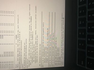

I’ve attempted the suggested trouble shooting techniques and was able to access my terminal to attempt to power on the extender as demonstrated. Unfortunately my device still won’t power on. I’ve provided a picture of the terminal information.

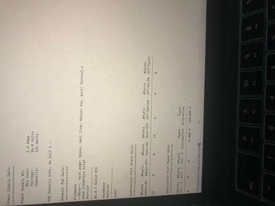

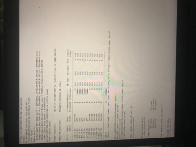

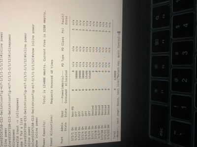

Here are the following commands.
