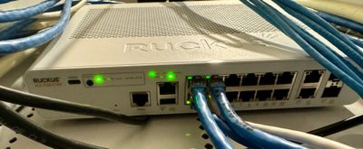

  2. On your switch while it's plugged into the outlet, do you see any lights on? (Amber or green) Please let us know which lights are on. (Please refer to the below picture and share a picture of the same, showing the light status and the FULL Switch panel cable connections to the Switch ports)

Here are the answers to the questions asked:
  1. The Ruckus was working before and I started experiencing the issue only after power outage.
  2. There are lights on , have added the picture for reference.
  3. Internet connection from the ISP is stable and working fine.
  4. I have 3 APs connected to the switch ( 3 lights are on - PWR, 2.4G and 5G are green) Picture added.
Hi @richjeet
The CTL light should only be illuminated on one of the APs. The AP with the illuminated CTL light is the master AP, while the members should have that light turned off.
Now, concerning the problem, it appears that you are encountering a "Routing code issue," which seems to have started after a power outage.
