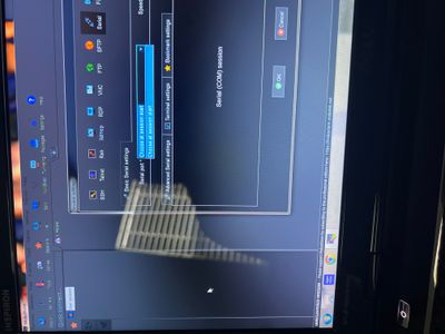

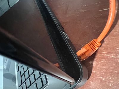

Here is the screen shot in MobaXterm where it is supposed to find the serial port and it doesn’t. I downloaded the Windows drivers that were provided and stated they installed successfully but again I am not using a USB connection so not sure if those drivers will work?
09-18-2024 09:57 AM
Hello @DubV52 ,
Thank you for the response and for sharing the screenshots.
Once again, please make sure to download the zip drive for the file below & "extract all". Once it's extracted, run the file, the driver should be installed using the 2 links below.
Link 1: https://support.ruckuswireless.com/software/1414-brocade-ruckus-7150-usb-serial-driver-windows
Link 2: silabs.com/developers/usb-to-uart-bridge-vcp-drivers?tab=downloads
Could you please unplug and plug your Switch from the power outlet and check the COM port details in the Device Manger from the Control Panel?
COM port details should be with the silicon lab name in the device manager.
