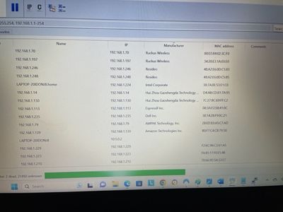

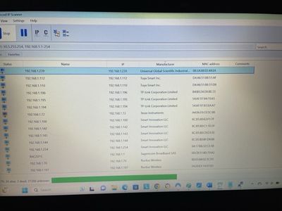

Hi @Wecovernc
Please check the other IP Addresses from the IP scan results, if there is any IP Address by the Manufacture name Ruckus Wireless or Brocade Communications which will be the IP Address of the Switch.
Thank you again for your patience and understanding
 these two are all that show
