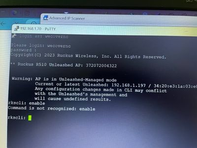

07-31-2023 04:15 PM
I have two up addresses.
mine takes me to the GUI I sent images of. The second ruckus ip address. Takes me to a ruckus r510 see this screen shot.

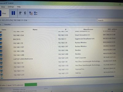

07-31-2023 04:22 PM
Hi @Wecovernc
Could you please share the screenshots of all the IP Scan results?
Thank you again.
07-31-2023 04:45 PM
Here
