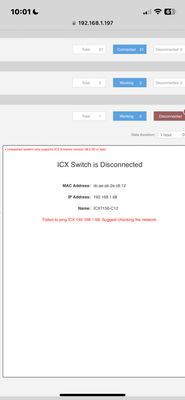

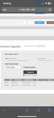

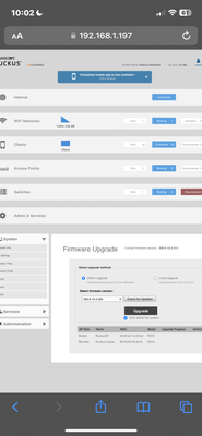

I have an icX router in my Lennar home. Every time the power goes out we have a connectivity issues. I also did a firmware upgrade but still have issues and you can see that. I also have we’re says the switch is disconnected.failed to ping
