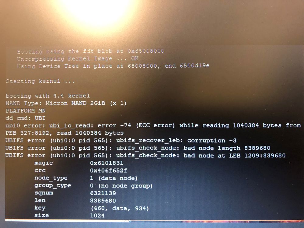

Woke up after power outage and internet was out; no lights observed on the APs. SYST light on the switch was flashing green. I unplugged the switch and plugged it back in and no change. I then performed a hard reset as per the instructions on the forum and looked at the output from the console using PuTTY. Error is given below:
Starting kernel ...
booting with 4.4 kernel
PLATFORM MN
dd cmd: UBI
ubi0 error: ubi_io_read: error -74 (ECC error) while reading 1040384 bytes from PEB 327:8192, read 1040384 bytes
UBIFS error (ubi0:0 pid 565): ubifs_recover_leb: corruption -3
UBIFS error (ubi0:0 pid 565): ubifs_check_node: bad node length 8389680
UBIFS error (ubi0:0 pid 565): ubifs_checks_node: bad node at LEB 1209:839680
There is also a soft lockup CPU#0 stuck for 34s error message as well.
I lastly followed a guide from the forum on performing a software recovery for the ICX 7150 and that did not work either.
How I can I get this thing working? All my security devices and others rely on the APs.

Based on the troubleshooting done, you confirmed, and we saw that after the reset, booting up the Switch, and trying the software recovery process multiple times, the failure persists. This Switch unit Should be RMA (Return Merchandise Authorization) in simple words replacing it.

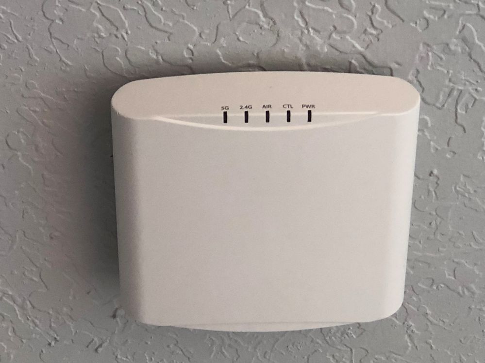

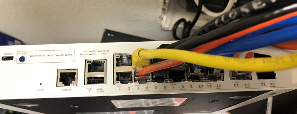

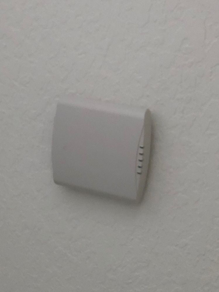

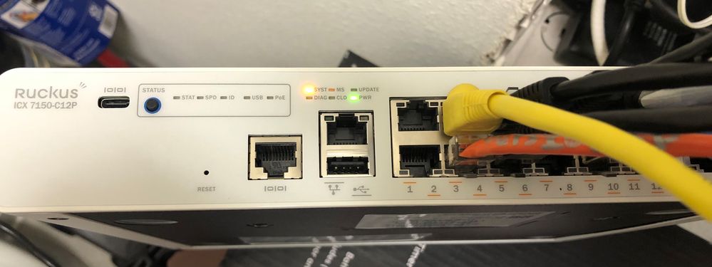

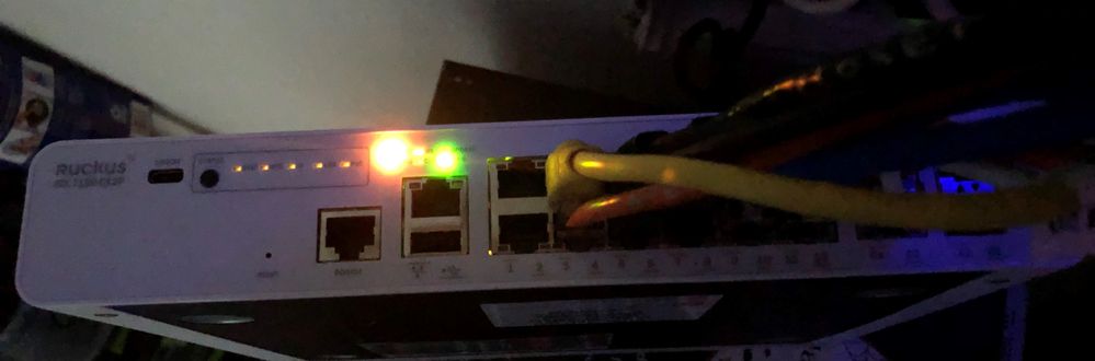

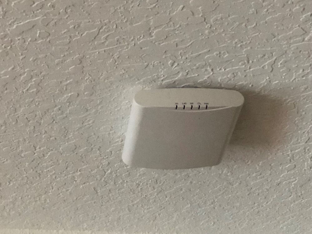

I do see lights on the ICX 7150, please see the pictures attached. The SYST light is solid amber. As I mentioned in my original post, I tried a hard reset according to the guide on this forum and it did not allow the switch to boot. I then followed another guide on this forum to do a software restore and it did not boot either. None of the 3 APs show any lights or signs of power.
I can confirm that my ISP router and modem are working properly. I was able to borrow a friends Unifi switch and connected the same cables in the same way they are connected to the ruckus switch, and the APs came to life and internet worked. I had to give the switch back, but it proves the APs work and its the ICX 7150 that is busted.AP 1 LightsAP 1 LightsAP 2 LightsAP 2 LightsAP 3 LightsAP 3 LightsICX Lights 1ICX Lights 1ICX Lights 2ICX Lights 2ICX Lights 3ICX Lights 3PuTTY Error LogPuTTY Error Log
Hi @chris_marquez_k
As you mentioned and I can see from the pictures you shared, there are lights on PWR and SYST, if there is an amber/orange light on the "SYST" and a green light on the "PWR" on the Switch (as it is in the below picture). Meaning the Switch is stuck in the boot mode.
Basically, due to the power outage/ power spike, the switch went to a state that we call ‘boot mode’ that is not able to boot up properly.
