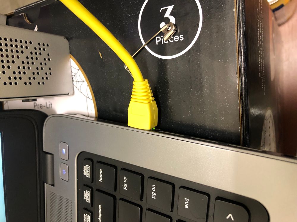

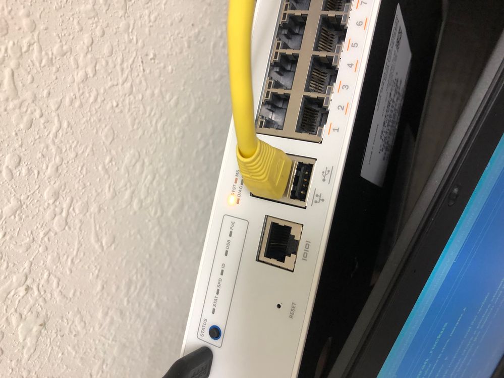

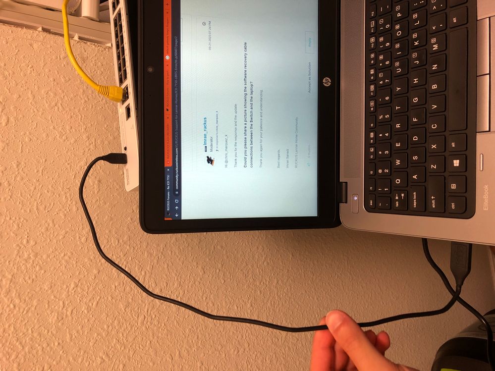

Could you please share a picture showing the software recovery cable connections between the Switch and the laptop?
09-21-2023 04:46 PM
Of course. Here are the connections.
