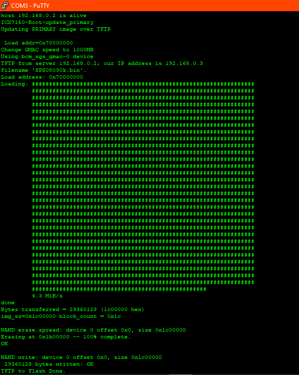

I was able to surpass the "not alive" hurdle by tweaking the gateway IP. (For anyone following along that is a novice like me, the guide shows the gateway IP address as being the same as the IP address when configuring the TCP/IPv4 properties. My computer was immediately clearing the gateway IP as that isn't valid.)
Anyway, once this was done, I was able to continue on with the steps of updating the primary and secondary partitions. This is the relevant code for the update_primary:Primary Update
After updating the primary, I updated the secondary:Secondary update

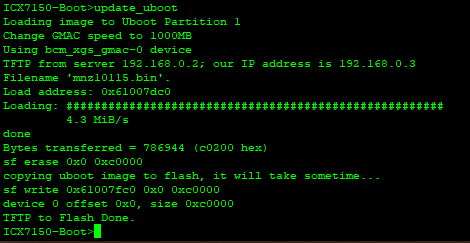

I then updated the uboot:Update uboot
Lastly I ran the reset command. After on the boot, it ran from the primary partition and failed all the same. Same exact error message. I unplugged the switch and booted from the secondary to ensure it was completely bricked, and it also failed to boot from the secondary.
Imran, I appreciate your assistance and walking me through this process. At this stage, I feel safe in saying the switch is in fact, corrupted. I have tried all avenues multiple times.
