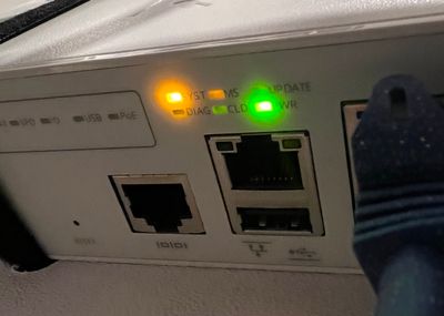

Had an internet outage from our provider last night. Ruckus doesn't appear to have reset. Others in the community have reestablished their connections, so I'm not sure what's going on. Called our Service Provider and they've indicated that the modem and router are working. We can get connected to the SP Router, but it's local to the closet where it's installed (very poor connection in my home office on the other side of the house. I've attempted a power reboot of the Ruckus multiple times. All I'm getting is a yellow light on SYST and a green light on PWR. According to what I've seen, that indicates it is stuck in the boot cycle. I've unplugged the unit, pressed the reset button and plugged it back in numerous times. I've finally gotten it to flash the LED's all yellow. However, that's all they do. Flash yellow continuously for 5+ minutes.

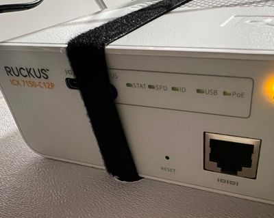

2) Could you please upload the pic of the front panel of the switch ?

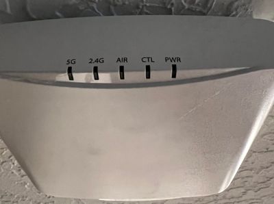

3) If AP's are connected to the switch , Please help us with picture of the front panel of AP device as well to note on LED indication.

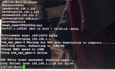

4) Please check the below link and try taking a console access to the switch. Try to do a software recovery . In case you are encountering a issue during the upgrade procedure or during console access to the switch. Please upload the picture to this post.

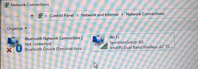

Here are the photos of the Ruckus unit:
here is the AP:

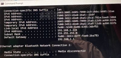

Here is the screenshots from PuTTY and my computer config.
I hope these are viewable.
thanks,
