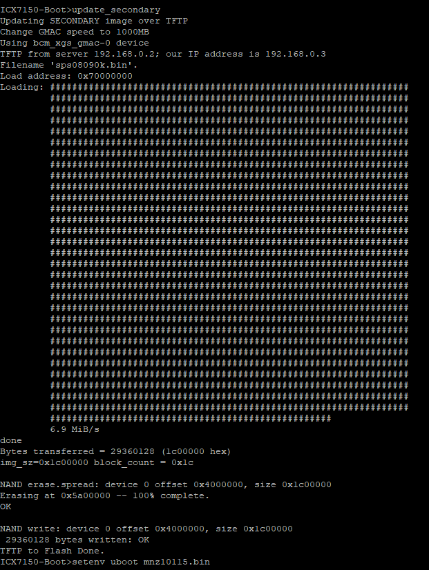

Turning off the firewall seems to have been effective.  I've been able to update the Primary, Secondary and Uboot files with the two files in the Update 08090k folder.  Here's a screenshot of this:

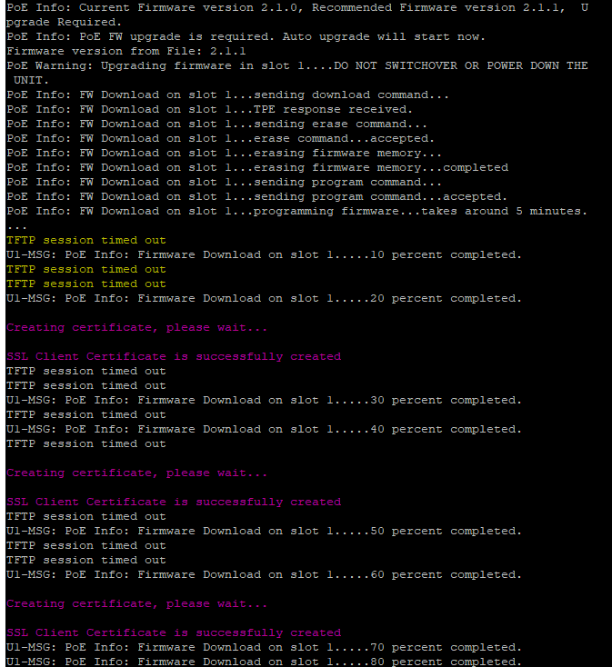

I continued with the reset command and it appeared that everything was processing, but I started seeing messages about the TFTP session timeout and SSL Certificate part way through the firmware udpate.  See below.  (TFTP messages in YELLOW, SSL messages in PINK)

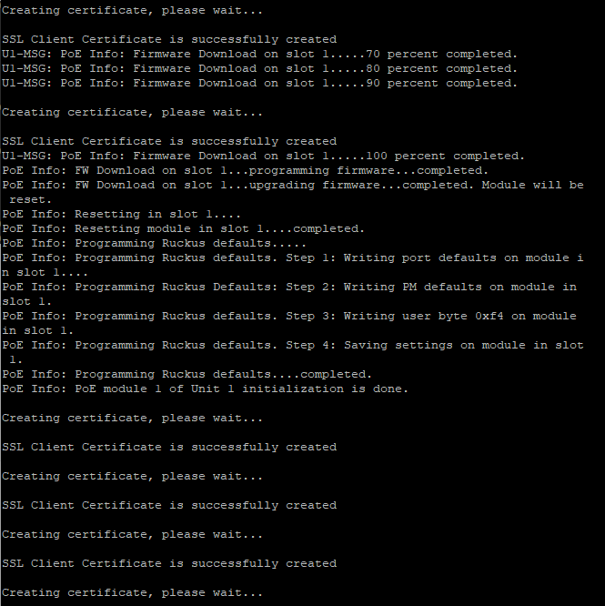

It appears that the reset is finished, but all I'm getting now is the SSL certificate message over and over.  It's not going back to a prompt.
I am now seeing three green lights on the switch display in STAT, SYST and PWR.
What are the next steps?  I'm not sure if I should reboot (unplug power and let it reboot) or not at this point.
