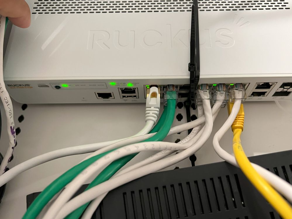

Please let us know how many access points are connected to the switch.
Please share the image of the access points as mentioned below.
you can also drag it to the chat
Also please check whether the devices are connected properly by using the below link.
07-11-2023 06:30 AM - edited 07-11-2023 06:31 AM
I have 2 Access points. I believe they are the R510 APs.
07-11-2023 06:32 AM
Please note that this was always working. Nothing was changed physically other than the updating the Switch.
