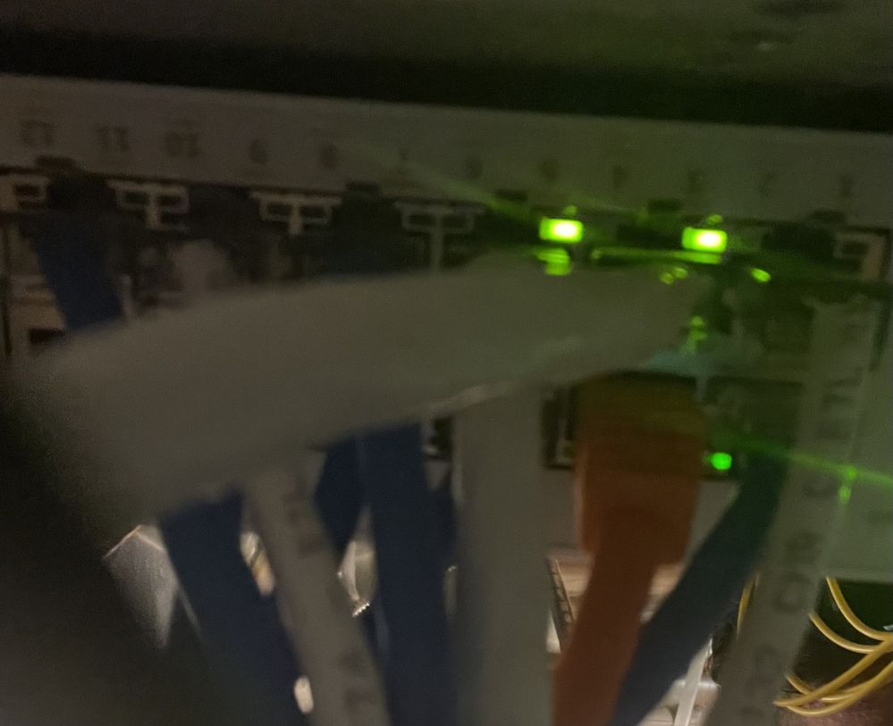

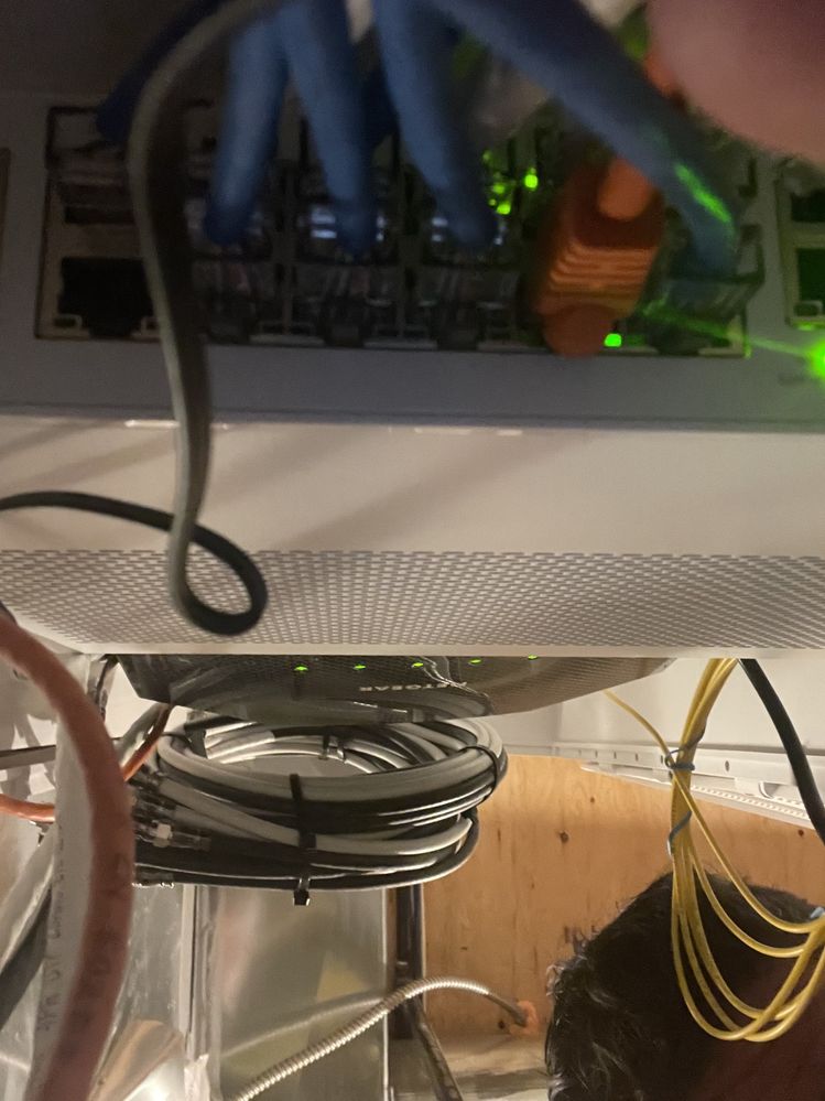

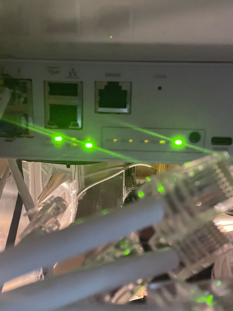

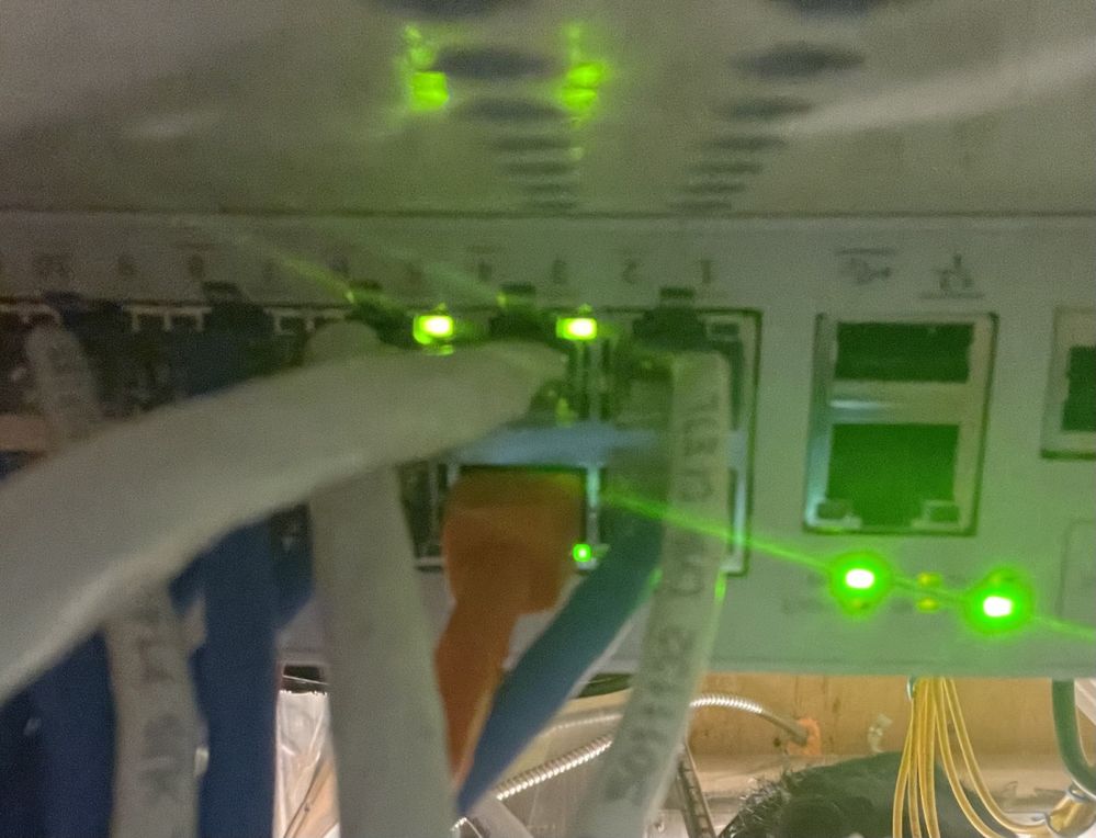

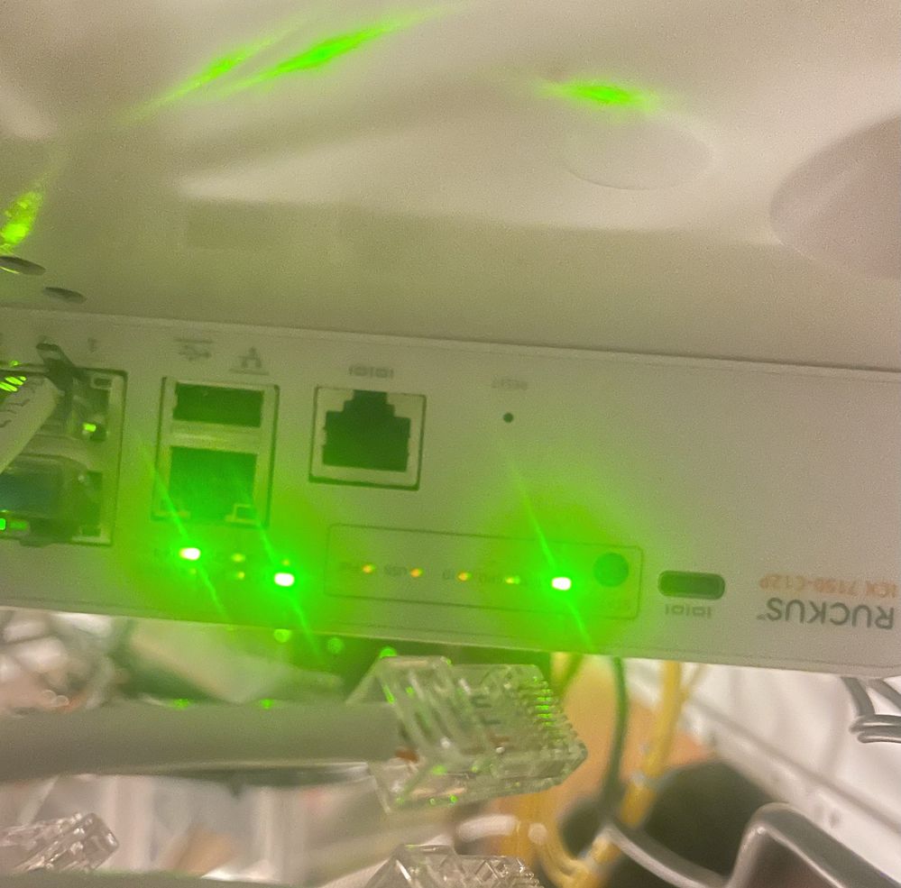

- Please refer to the below picture and share a picture of the same, showing the light status and the FULL Switch panel cable connections to the Switch ports)

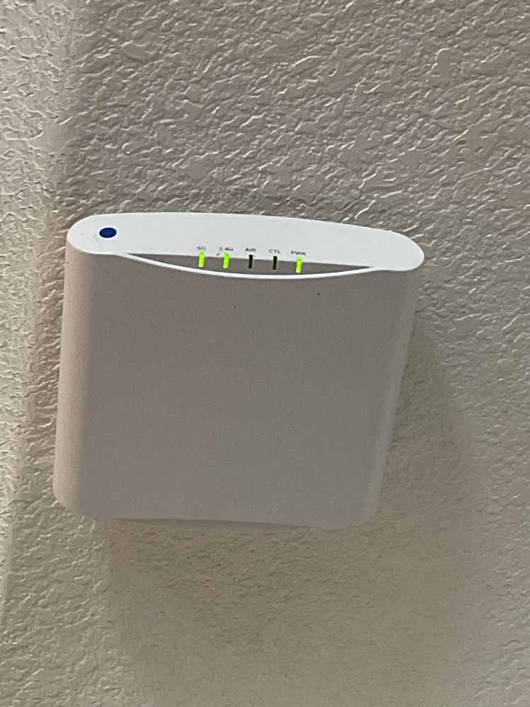

2. May I please know how many Access points are connected to the Switch and if all the Access points are not turning on?
Please help us with pictures of your ICX-7150-C12P Switch showing the status of the lights and cable connections to the Switch ports. Please share the status lights of the Access points too.

07-29-2024 08:18 AM
Hello,
Thank you for your reply.
Hopefully the attached is what you are looking for.
There are two access points connected to the Ruckus. Their lights are all green - every once in awhile the 5g will turn amber but then flip back to green.

07-29-2024 10:14 AM
Hi @Kerickson516 ,
As per the light status I see from your screen shot, I see that the lights are in the normal state and we need to check few switch configuration details to understand the issue better and assist you further.
