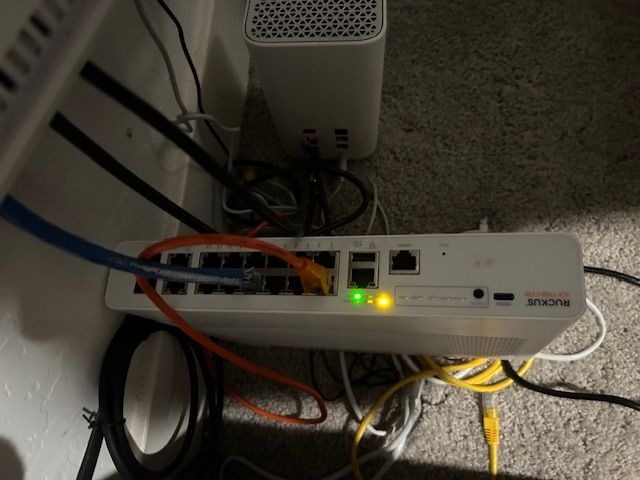

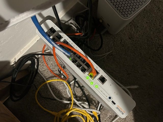

this is all thats plugged in
if you try to reboot it turns to amber for awhile but never lets the reboot happen
here are the photos.... nothing is connected. We had to move everything since it failed to allow a reboot. I hired Geek Squad to come to my home and reboot and they also stated above that its not working properly. Please let me know what to do to get this back online

As per the light status of the RUCKUS ICX-7150-C12P Switch, it seemss to be in a normal status.
As I see from the picture you shared, seems like the ethernet cable which is coming from the ISP’s (Internet Service Provider’s) Router or Modem/Router combo is plugged into the wrong port on the Switch panel. It must be plugged into any 1 in-12 ports as shown in the below screenshot. Please unplug the ethernet cable plug it into the correct port and reboot (unplug/plug from the power outlet) your Switch and ISP Router once then try to connect to the Internet via Access Points.
Please check and let me know if that works.

OK moved it over like you said and now its back to one amber light. How do I reconnect from an access point? This is why I had Geek Squad out because I dont know about any of this. You'll need to fully explain everything. I moved the wire over and unplugged and plugged back in and here is where I am. Please advise
