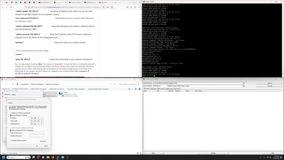

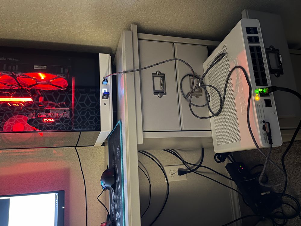

Well I was able to console in and I changed all my settings per the instructions but I am stuck with a 'host not alive' issue. Attached are the images of how I have the switch physically connected to the pc and the a screen shot of the settings. Not sure where to go from here.IMG_5918.jpghost not alive.jpg

As you are getting a "host 192.168.0.2 is not alive" error.
Are you turning off the Windows firewall? If not, please turn off the Windows firewall and retry the software recovery process once again.
Please refer to the below link on how to turn off the Windows firewall:
https://support.microsoft.com/en-us/windows/turn-microsoft-defender-firewall-on-or-off-ec0844f7-aebd...
When you turn off the firewall, please close the putty and restart it once again, restart the software recovery process from setenv IP configuration.
Please let me know if you are stuck at any point in the software recovery process.
