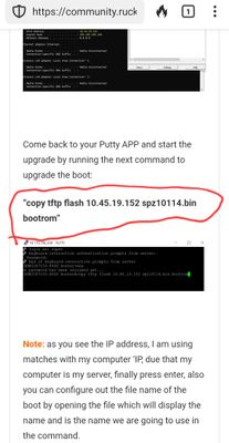

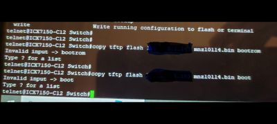

I followed the instruction for ftp and telenet but I am stuck as the first command in the instruction is not working.
Now, of cause I replaced the ip address with mine and changed the file name to mnz... but it keep telling me "invalid input -> bootrom".
I even tried changing it to boot but get the same error msg.
Please help.

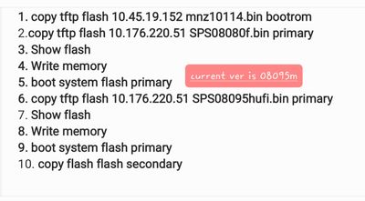

Hi, to clarify, the instructions for the link you provided yesterday list the sequence of commands as follows:
Are you now saying I should ignore steps 1 through 5 and just do steps 6 to 10?
What I reported yesterday was that I couldn't get past step 1 because it gives me the error below when I enter step 1 command:
Also, for the 08095, current version is 08095m. Can I use the current version or are you saying I should be using the 2021 version of 08095g?

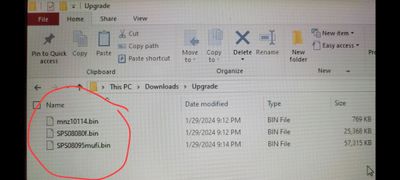

As you can see below, have downloaded and unzipped the files I need, I just need the correct commands sequence to do the upgrade.
