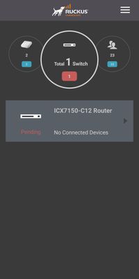

02-02-2024 04:47 AM
So even though the above solution worked and all ap are now up and running, my wifi speeds have really decorated, very slow to load any page. I logged unto unleash and took a screen shot of the switch and it show below.
02-02-2024 05:14 AM
Hi @Johnnyy5ive
Thanks for your response,
To find out the root cause of the issue please confirm whether the issue is occurring while it is connected to the access points or when it is connected to the ISP router.
Please follow out the next steps.
1. Please connect the computer to the ISP router with the ethernet cable. Run the speed test, and confirm if your speed is stable and search for the websites, make sure you have no issues.
2. You can perform the same step on wireless by connecting the computer to the Wi-Fi/SSID coming from the ISP router. (Note: not the Wi-Fi coming from the access points.)
