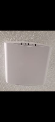

Hi, last week I was having an issue where my APs turn them self off (no lights on any of them). I rebooted the router and went into unleash, updated the firmware to the latest version per instruction on  this forum but the problem still persist. After router reboot, the APs come online for about an hour then go offline. I have two r510 and they both go off at the same time. I have double checked each of them and they currently have the 200.15.6.12.304 firmware. Please help.

To find the root cause of the issue please share the image of the switch showing the LED status and the cable connections.
APs come online after I reboot switch, but stays active for about 15 to 30 minutes and go offline. It does not turn itself back on unless I reboot switch again, then the cycle repeat. 
Valued Contributor III
Hi @Johnnyy5ive
Thanks for your response,
Based on the images you have shared it seems like the switch has green lights on PWR and SYS on it which means that the switch is in normal state.
