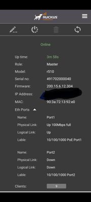

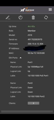

01-28-2024 04:18 PM
Attaching screenshots from unleash showing current firmware.

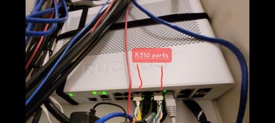

To find the root cause of the issue please share the image of the switch showing the LED status and the cable connections.
01-29-2024 06:36 AM
APs come online after I reboot switch, but stays active for about 15 to 30 minutes and go offline. It does not turn itself back on unless I reboot switch again, then the cycle repeat.

Hi @Johnnyy5ive
Thanks for your response,
Based on the images you have shared it seems like the switch has green lights on PWR and SYS on it which means that the switch is in normal state.
To find the root cause of the issue we need to take console access to the switch to verify whether the switch is able to transfer the power via 12 ports.
