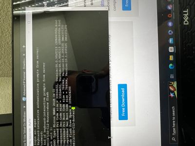

Hi, I was able finally telnet into the device and it appears both the primary and secondary code is router.  I do not see the switch code in either.  I do have a Lennar home.  How do I resolve this?
Here is a screenshot.
Chandini
RUCKUS Team Member
Hi Rleschber
Ack and Noted. Thanks for reverting back.
Below is the link to firmware 8095h :
After downloading the firmware from above link
  • Unzip the folder
  • Go to 7150 folder -> Images folder -> choose "SPS08095hufi.bin" for the upgrade methods given below
Refer below links to upgrade to SPS firmware
How to upgrade a Switch ICX7150-C12P via TFTP (YouTube link)
Software Recovery method
I hope the above links help you.
Thanks
