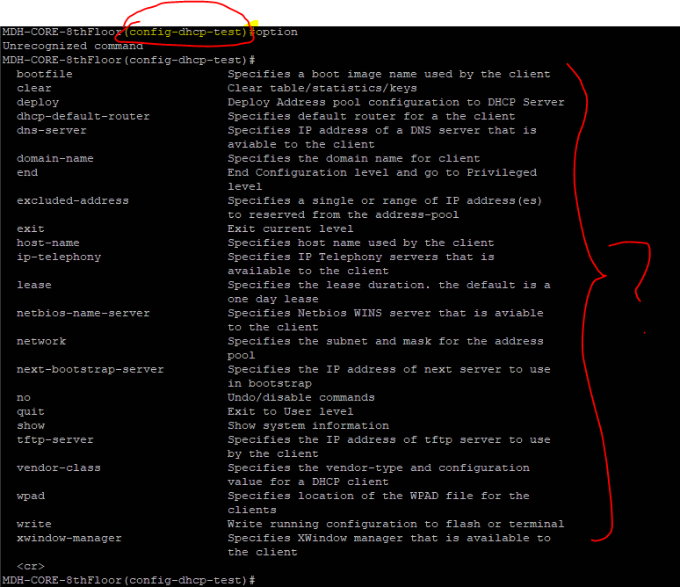

Hi @syamantak_omer I'm trying to configure Op43 but I'm unable to see the command. ICX7450, Router image, 8.0.60
I read the DHCP Op43 is supported from 8.0.30mb onwards.
https://docs.commscope.com/bundle/fastiron-08090-dhcpguide/page/GUID-F9B2D285-4EB9-46B8-A4AB-AD4FF38...
Also, I noticed that the prompt I get for DHCP config is different from that one that's shown on guides (Attached). What am I missing here?
Image_ images_messages_61517ed899ef1c5003639948_147040829eed533a997b6cdc0f429e79_dhcpop43-536b2ea2-b18b-461b-9a4f-ac0e45314c06-1604433452.PNG
Dear @rajivw,
Could you please share complete switch configuration ?
Abilash PR
