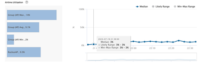

We just upgraded from 6.1 to 6.1.1 last night and this button seems to be missing from the AP -> Health airtime graph. The pie chart it opened up was really useful for determining if an AP was having high CCA/Utilization just from itself being busy or if it was caused by other neighbour networks and/or interference.

The Airtime Detail option was deprecated due to a bug that was showing the wrong statistics numbers on the output. The fix is deferred to 7.0.

Could you please confirm if you are asking about the below Airtime graph on the SZ 6.1.1 ? Please confirm which SZ model you are using ?
