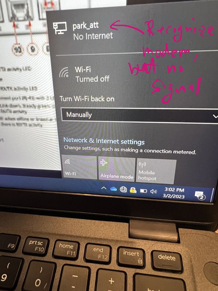

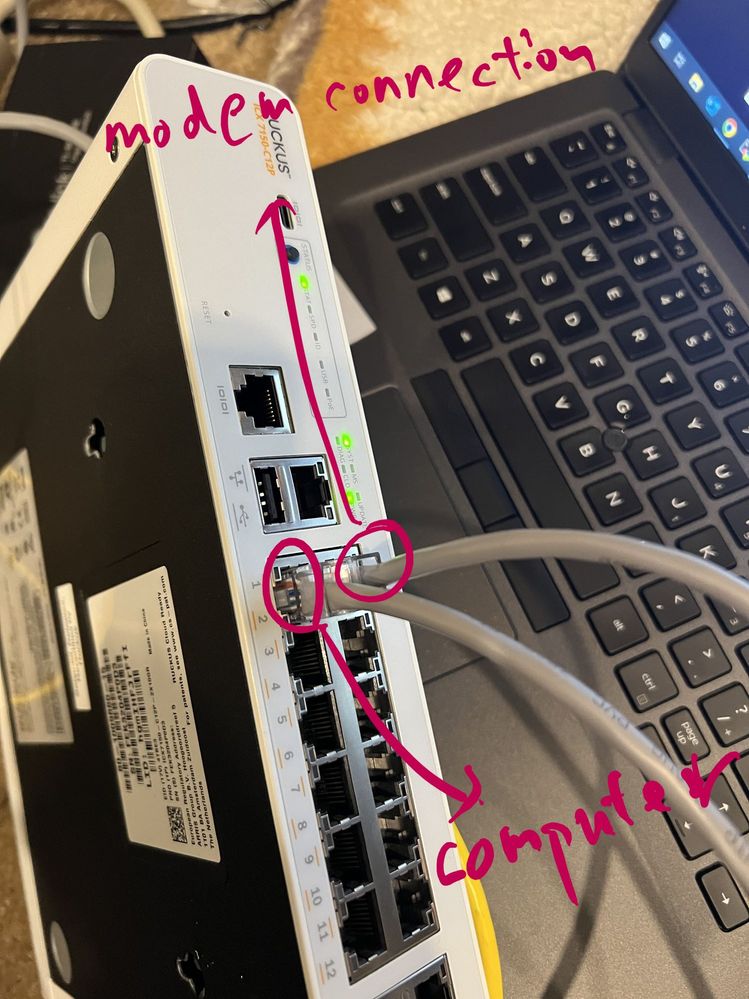

I received a replacement.  After connection, green lights are on, but no internet connection.  I wonder if I connected correctly.  Please let me know.
Meanwhile, when I tried my own switch, it worked fine.
Hi robinparky
Hope you are doing well!!!
Apologies for the delayed response on this.
As per the case description, I could understand that you are unable to access the Internet from a newly replaced Switch.

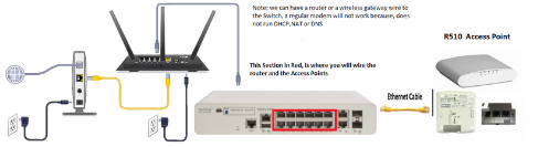

The picture/photograph you shared in which it is mentioned as a ‘Modem Connection’. Could you please confirm if it is a Modem or a Router? The connection must be from a Router or Modem-Router combo device.
Please refer to the short guide link below as a reference about how to connect the devices:
Lennar Home Community.

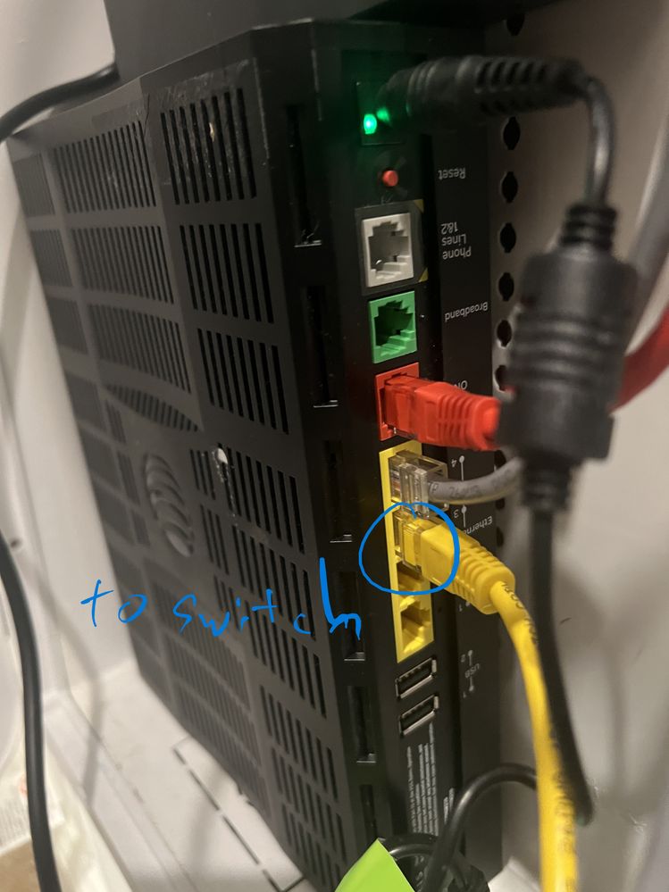

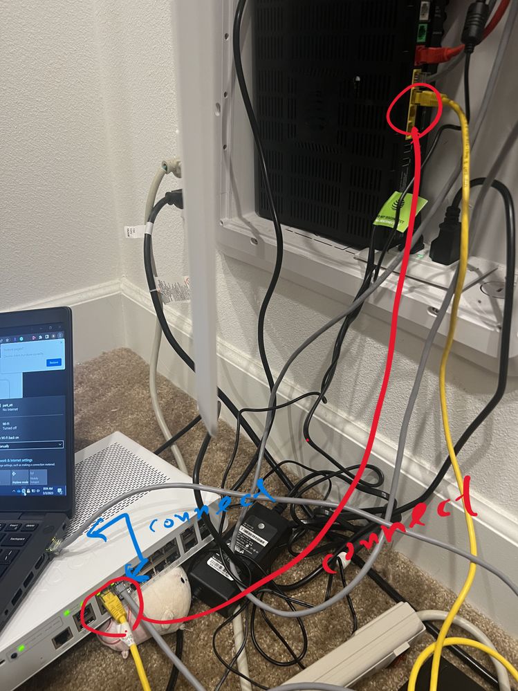

It is a modem router combo.  See the connection below. Still, not working.  When I tried the same connection to my personal switch, it works.
