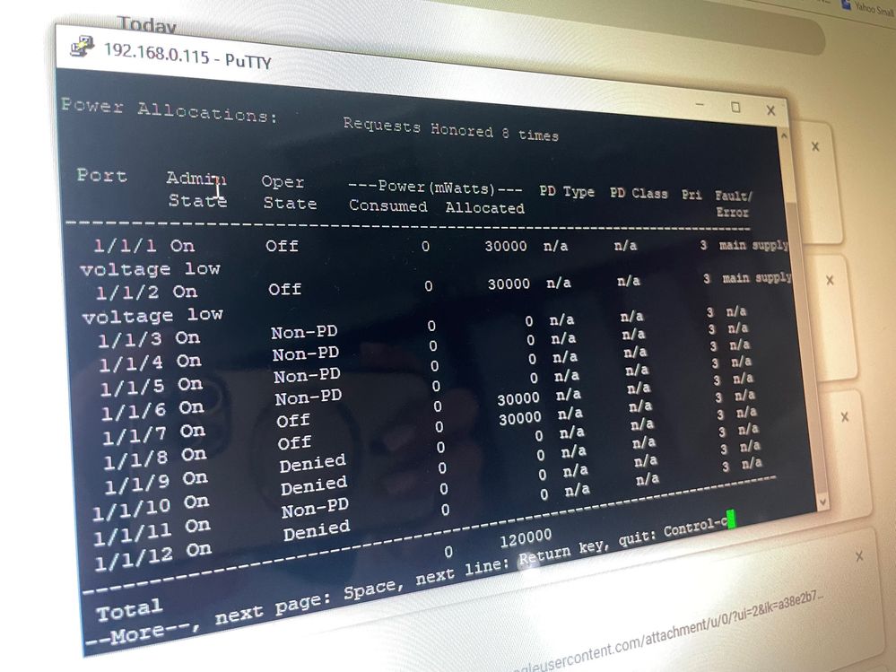

Could you please check if all the ports are ON which were Off I marked in the screenshot. Use below commands to check.
show inline power
Please check and share a screenshot of the same.

Hi @nwi2247
You are unable to get Power on your Access Points because of low voltage. As marked in the below screenshot.
Please reboot the Switch once by performing the below commands:
reload
y
Please check the Access points once the Switch comes up and confirm. Again there is a low voltage issue, we could proceed with an upgrade of the Switch.
