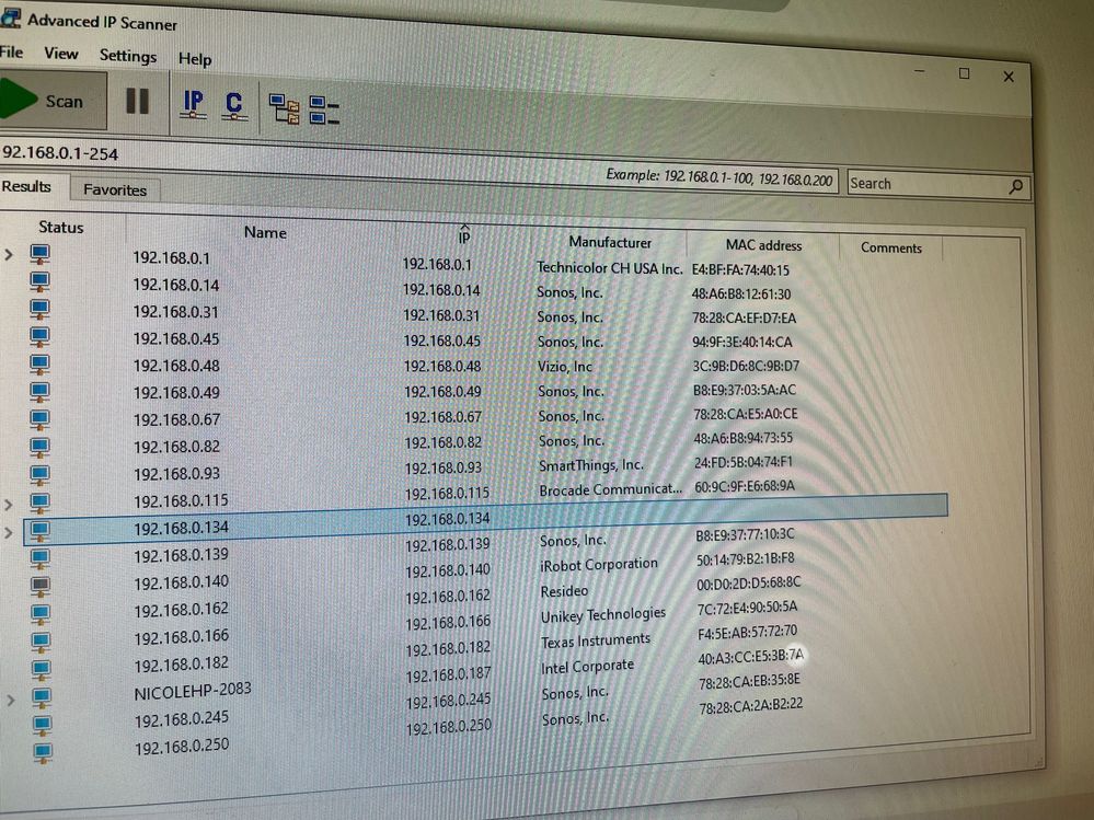

When I did the IP Scanner  Ruckus Wireless does not show up in the list of Manufacturers.
Hi @nwi2247
Thank you for the update.
Could you please share a screenshot of all the IP scan results?
Hi @nwi2247
Try the IP address one with the Manufacturer Brocade Communications as marked in the below screenshot.
https://0.0.0.0 or http://0.0.0.0 (IP address of Switch. 0.0.0.0 is just as an example)

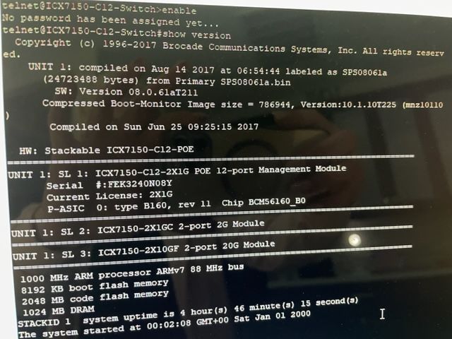

Once you confirm the Switch IP Address, please try to access the CLI as mentioned in the previous post guide.
