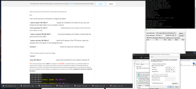

On the procedure document I have followed up to the following
And now is coming across this error indicating `not alive`
Any suggestions would be greatly appreciated.
06-23-2023 03:34 PM
Hi @tmsuzuki
Thank you for the response and the detailed information you shared,
Please follow the same process, use the same IP Addresses and other configurations we have mentioned in the guide.
Are you turning off the Windows firewall? If not, please turn off the Windows firewall and retry the software recovery process once again.
Please refer to the below link on how to turn off the Windows firewall:
Please let me know if you are getting the same error or are stuck at any point in the software recovery process.
