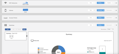

Hi.
Im having some issues with all 4 of my access points and ruckus switch, after a power loss two weeks ago. the internet connection as been intermiten when devicies connect to the access points, the conection becomes on and off randombly, also making my apple devicies and window computers not connect to the internet. can some one help me with this. i tried power cycling the network switch, and the access points. i also had att replace the modem and i still have the same result

I found the IP of the Switch - 192.168.1.235 this was through my att router. The ip application only found my 4 AP and now switch. When going through PuTTY and connecting through the IP i get the same black screen as connected directly with the USB C on front of the switch

im using 4 R510 access points. I tried doing the CLI using putty and my Mac Terminal connecfion and i get unable to connect. so basded on the gui interface they been running for 22hrs 30min. as for the switch i receive this from Lennar and i belive it as already set up for someone else so i dont know the user name and password for the switch. i've also tried connectin to it using putty and telnet connction with no success.
