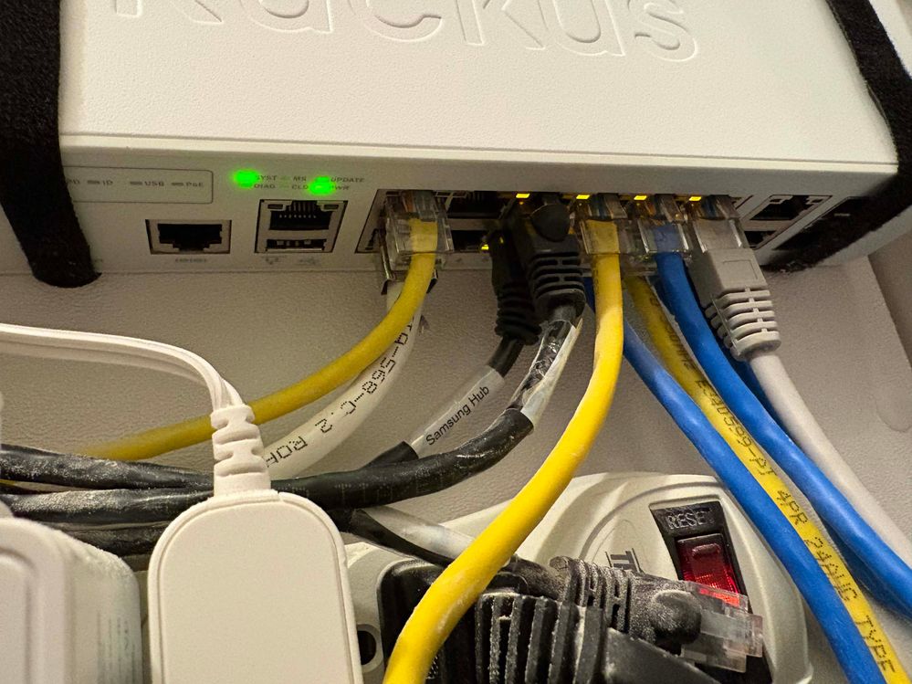

My wifi router does not work (LED lights are off) after power outage.

From the screenshots you shared, I see that the PoE is disabled on your Ruckus ICX-7150 Switch.
To fix this issue and enable the PoE on the Switch, please perform the commands on the CLI:
Switch>enable
Switch#configure terminal
Switch(config-mif-1/1/1-1/1/12)#inline power
Once you perform the above commands, all ports should be On, and Access points should get the power.
Once the RUCKUS ICX-7150-C12P switch ports come online, it should fix the issue.

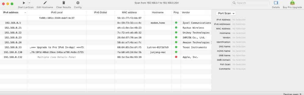

Hi Pinky
Does this work?

Hi Pincky
I see the Ruckus wireless in the list of IP address.  Is this the correct device that I need to get access to CLI command?  I just want to make sure that I am looking at the right device.
