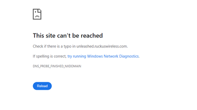

I have tried several times to login to both the online unleashed (the link you provided above says that this is not a valid website. When I manually type in the address it takes me this site that we are currently on. I posted the pick below. I can't login on my app because it keeps saying I an not linked to the internet and to go to settings.
