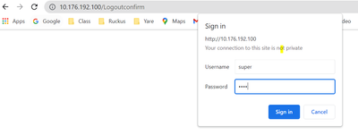

3:Find the IP address of the Switch and try to gain access via web, important your computer must be online, so you can connect it directly to the ISP router in case the connection directly to the switch dies no work and provide the next information
A:Now that you know the IP address of the Switch, in my case my IP address is 10.176.192.100, search for that IP address in the URL bar of your Web browser:
B:Hit login and the credentials must be
User: super
Password: sp-admin

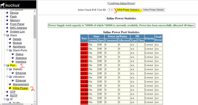

C: Now that you have access to the Switch, let's check the PoE status, please provide the screenshot of the results.
port>inline power>inline power statistics
